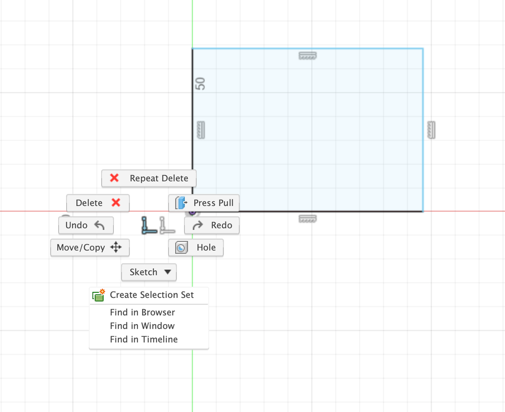

I have researched everything that I can find on this topic of "Moving Sketch Objects". I have attempted to move objects on numerous projects that I have drawn and machined using only Fusion, including many full 3D parts. I have tried every manner of moving sketch objects and have been entirely unsuccessful. I am fluent in 17 CAD/CAM programs with 27 years of CAM machining experience. "Move" only works for me on "Bodies". Does anyone have any suggestions or tip/tricks that I may be missing, or does the "Move Sketch Objects" just not work? Thanks in advance.

If you have problems moving sketch components it is quite likely there are some associated positional constraints which need to be removed before the move will work, make sure that in sketch mode you have show constraints checked and start removing the positional constraints, particular associated with dimensions to other objects which may or may not be associated with the sketch under consideration is a good place to start.

every sketch has a fixed point at the origin that is not deletable.  If you snap to this point when creating geometry, that part of your sketch will be immovable.  You can remove this by hovering over this point, selecting the coincident constraint:
and then deleting it:
