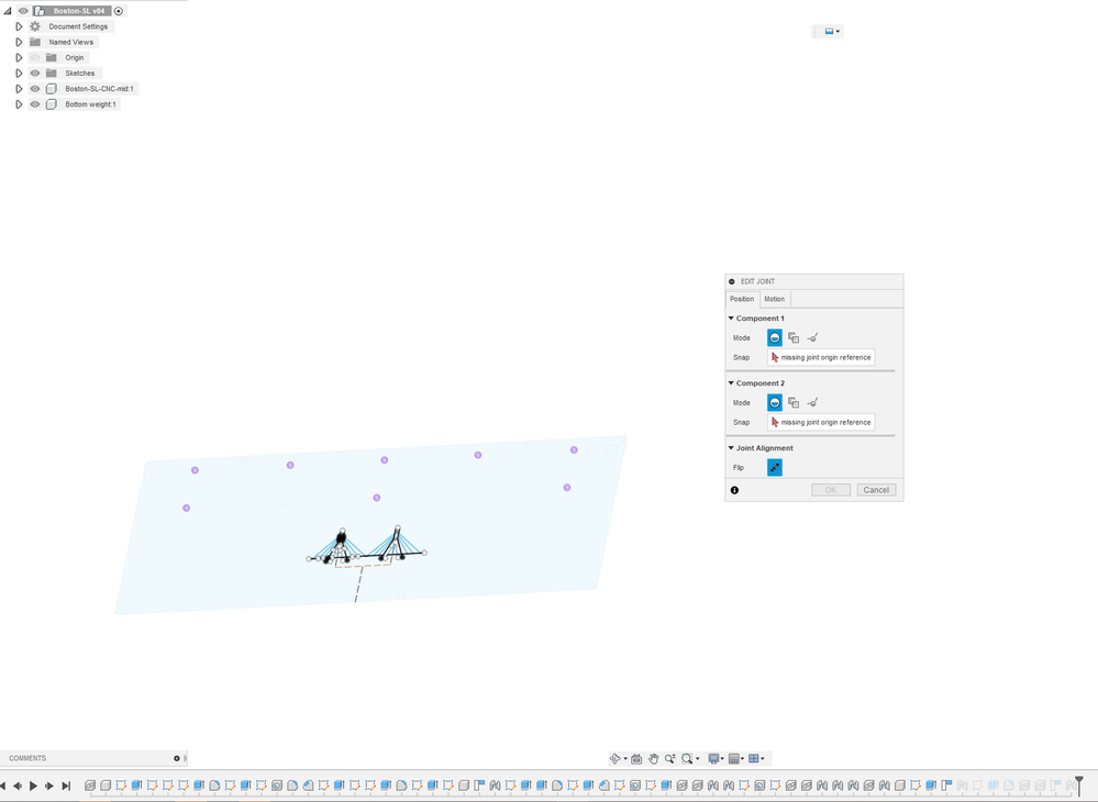

I went and opened the linked component file, updated its appearance, and saved it, and pressed "Get Latest" after doing so, and it seems to have completely broken the file I was using the linked component in. Most of the new components I have made have disappeared from the Feature Tree. All of my features in my design history, though, are still there, though they are missing references:
Before "Get Latest" and after "Get Latest", and a random joint from the intact Design History missing all of its references.
Before "Get Latest"Before "Get Latest"After "Get Latest". Note most of the components are now gone, but the design history is intact.After "Get Latest". Note most of the components are now gone, but the design history is intact.A random joint from the design histroy. It's missing all of its references.A random joint from the design histroy. It's missing all of its references.

So I noticed that all the components that get deleted are independent linked components.
I can "Get Latest" on other components without issue.
Also, if I try to "Break Link" on the component that breaks the assembly, it says that it will be aborted due to the cyclic dependency error.
Apparently "Compute All" also breaks the assembly, and said that there was a sketch that was causing a circular dependency on another sketch. After deleting the offending sketch everything works fine.
