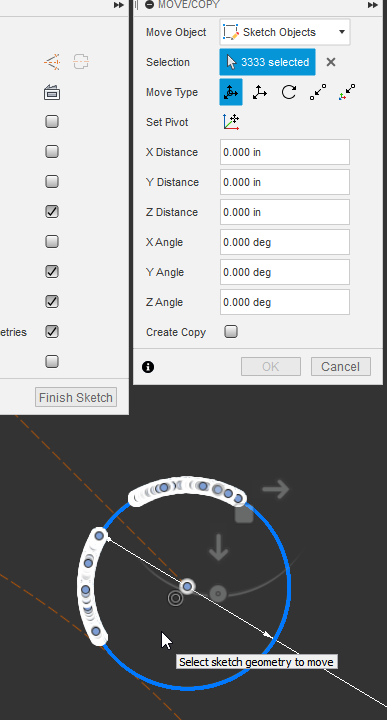

After enabling Show Projected geometry and window selecting and deleting all the small circles then intersecting it works correctly. @jeff_strater  Should hidden projected geometry affect the generation of profiles?

When you project the surface you are also generating all the intersection and these are quite complex curves. Also they will be closed overlapping splines and you are just overloading the solver. The closed splines are a big problem and probably should flag an error.
If I break the link to for the projected geometry and select with the move tool it list 3,333 items selected! This is going to be a problem.
