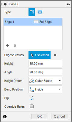

MatthewNZ
I'm having the same issue but don't seem to have the mitre option as shown in your video that would resolve it (See below screen cap). Has this feature since been removed or is it found elsewhere.
Thank you,
