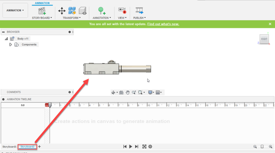

I am trying to create the drawing shown in file "03 Drawing goal..."  it shows a 3-view of a design and an exploded view of the same design.
I must use the animation workspace to help set the starting positions of my design.
I can do each by itself but not both on one sheet.
I animate to the first position and "Use animation" to create a drawing.  Get the results in file "01 DRAWING Sheet1 ..."
I then use the transformation of explode all and again "Use animation" to create the drawing.  I get file "02 DRWING Sheet2..."
I can't create the 2nd drawing if I try to to place it on an already created sheet - says the design is not up to date.  Because I animated it the second time.
Is there a sequence of steps to accomplish what I am trying to do?
Maybe I'm fundamentally missing something - like copy/paste a drawing and table from one sheet to another? I don't how to do that.
Your help would be appreciated.

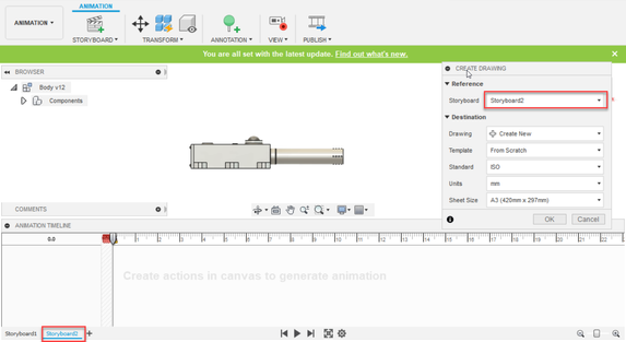

You can follow below steps to get required result.
  • Create 2 Storyboard (One with First position & One with exploded view)
  • Save the design.
  • Create drawing from animation & select storyboard 1.
  • Place view on sheet 1.
  • Again revoke the base view command in drawing on same sheet and select reference as storyboard 2(exploded view)
  • Place it on canvas.

Thanks for the answer.  I was able to repeat what you suggested.
I think a key part of your answer was realizing I needed to put the two views initially on two different animation storylines.
In your directions I would ask you to explain in more detail the following statement you made:
"again revoke the base view command in drawing sheet and select ...."
I have googled without success if there is a revoke base view command.  Seems not. could you explain?
Thanks again for your help.
nemadec
@JayWBeck
After placing the first view...just click the base view command button as shown in the fourth image highlighted in the red box.
