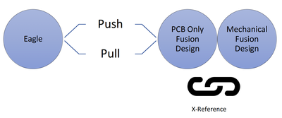

One thing you may consider doing is keeping the PCB board in its own separate design in Fusion 360. You can right click on this design in the data panel to insert this design into another design in Fusion 360. This is called an X-Reference. The upside to this approach is that you're less likely to be editing the Fusion design and overwriting versions that have been pushed from Eagle.
The downside is that you have to Open the X-Referenced design with the PCB board in it to make edits to it. It cannot be edited in-place.

   With respect to the workflow,  I am still trying to grapple with how the fusion-sync implementation results in seamless ECAD-MCAD workflow. Just to reiterate your comments:
  If the PCBA is part of a larger mechanical design, then it seems that:
    a. Pushing from eagle to fusion will result in loss of interim progress/changes - that is unrelated to PCBA itself - within Fusion; should one accept the new document revision in Fusion.  This is because, the scope of the Eagle push-pull link extends beyond PCBA component and to the entire design that embeds the PCBA component.
    b. Xrefing the PCBA design into the mechanical design will fully mitigate a. However, this approach will not allow in-place push to Eagle since, understandably,  Xref is unidirectional.
Therefore, given the uncertainty and consequent anxiety produced by a,  X-refing seems to be the only reasonable way to work with this fusion-sync feature. At that point, given the limitation in b, from a users perspective, what is the difference when compared to a traditional step file based  (or other solid model file format based) approach?
