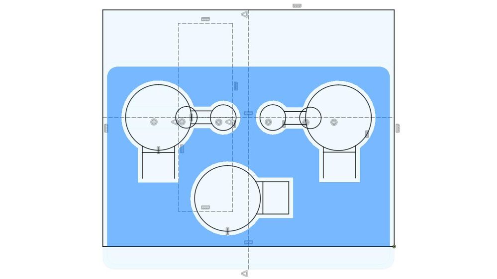

Hi guys, this one is driving me nuts.  How do I prevent the profiles of projected geometries from being selected?  The selected profile shown here is from the underlying projected geometry that was generated from an existing body.  I have that reference body (and all other bodies) hidden and the projected geometry for the active sketch is also hidden.  All other sketches have "Show Profiles" disabled.

Can you upload the model? Does shutting profiles off in THIS sketch disable all of them? are other sketches visible?

I will see if I can figure out how to upload the model, I'm new to the forum.  I've been using F360 for quite awhile, but this is the first time I've had an issue I couldn't find the solution for.  Yes, if Show Profiles is disable for the active sketch then no profiles can be selected but the hidden reference lines do show if I hover the mouse over them.  No other sketches or bodies are set to visible.

It’s a Preference setting.  When automatic project on sketch Create is on, Fusion will Project the face the sketch is created on.
It will show you the profiles, but, you only have to move the mouse away from those profiles, to unhighlight them.

Still seeing the same issue so I created a simple test project to try and figure things out.  As you can see in the image below, if I wanted to extrude the square and leave a hole per the active sketch I would need to click on the "hidden" profile as well as the hole in the active sketch.  Not a big deal for something this simple, but for more complex models it can lead to tiny profiles being left out of the extrusion.   I've attached the model file and a pic of my Preference settings.  Thanks for your help, I'm sure it's something simple that I'm just not seeing.

You have projected geometry in that sketch that is off in the sketch settings. This will still generate a valid profile in the sketch. You'd need to remove it to clear those profiles.
