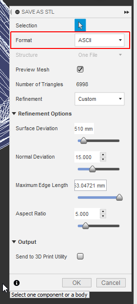

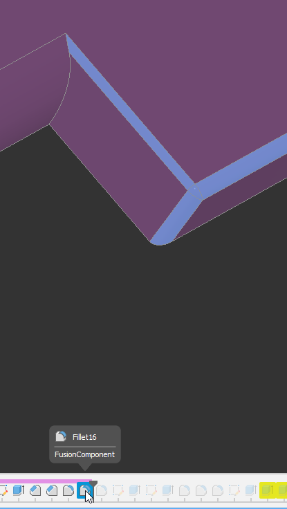

HughesTooling
@Anonymous  Not sure why but this fillet makes it fail. Odd thing is if you export as an ASCII file it works!

How strange! thank you for your time and effort! i found another work around were i saved it as an .obj and my slicer software recognizes that!
