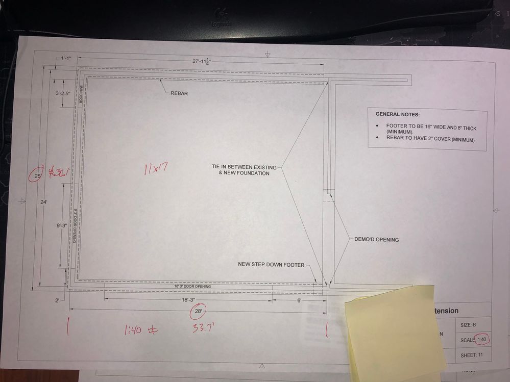

Model space has not been changed from 1:1, to my knowledge it is 1:1. I select drawing (from design), to size b 11x17.
I scale my model down to 1:40 in drawing space, dimensions carry through correctly to the drawing space and I print directly to my epson ET 15000, size 11x17 & scale 1:1.
I have also tried printing to pdf, then sending to the printer with same error in scaling.
28' distance scaled at 1:40 prints at 33.7' instead.
Ive read some avoid this by sending to dxf, unfortunately autodesk wants $70/month for that feature. PLEASE help.

The paper size is sent to drawing as 11x17, the drawing is also sent to the printer as tabloid (11x17) scale 1:1.
In pdf if I measure it it comes out correct: 8.4" scales 1:40 = 28'
Ive uploaded the drawing and will now look at the first link posted by ClintBrown. It seems strange to me that a small variation in print setting would require 83.25% reduction in the print to actually print scaled correctly. That sort of scale difference is substantial so in order to get it printed correctly, the whole sheet has to reduce by nearly 17%. If we were talking a few percent I would accept its just a translation error and scale down appropriately, continue on with life.
If I look at the drawing view and note where the edges of my model are shown relative to the plot space, they are exactly where the printer is showing them. This makes me believe its not a printer translation error. Hopefully this makes sense, if you look at the most lower right point of the footer object in the drawing, you will see it stops directly above the 'r' in garage. When printed it is in the exact same spot and obviously the boarder/title box have not been skewed by 17%. Hence why I think this error is in the CAD program and I cant figure out why.

I also tried looking into a ClintBrowns article and have done a totally new test. Both 8.5x11 and 11x17 are skewed by the same factor for an unknown reason. (I cannot print to web as I am not a paying member, that function is greyed out)Scale text new model 8.5x11.jpg

In post #5 I show a screenshot of adobe and circled in red there is a measurement of 8.4 inches. That is using the pdf measure tool along the 28' (dimensioned) wall.
Is that correct since 8.4" x40 = 28?

I was more interested if printing that PDF to your printer is correct. You said in the first post that printing a PDF was also wrong but I wanted to make sure you still have that problem with a PDF you've measured. If you do still have a scale problem with a PDF file that Acrobat says is the correct size, surely the scaling error is down to the printer or printer driver?
Something you might find helpful is editing the border and add a line to use as a ruler for checking the scale. Geometry that's part of the border or title block should always show 1:1 dimensions.
