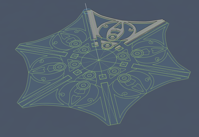

I use fusion 360 and I get several dozen of crashes a day on my Windows 10 machine as well as a Mac M2 Pro machine.
Primarily the issues arise from editing sketches with splines. Common issues are:
* Fusion freezes when deleting splines which are mirrored or patterned.
* Fusion freezes or crashes when applying constraints.
* The sketches palette dialog (with the finish sketch button) disappears when editing sketch.
* Each line drawn takes minutes to compute, fusion is unusable, or fusion crashes.
I've send in perhaps 300 or so error reports and never gotten a response and so I stopped my subscription. I was a subscriber and I would like to subscribe again. Are these common problems I get dozens of crashes each session.
For example in this file I can't draw another spline off the construction line without fusion crashing.
I would like an expert or support agent to get on a video call with me. Or maybe someone in the forum can tell me, is something wrong with the sketch I have here?
P.S. The first thing you might say is "wrong" with the sketch is that it is unconstrained. When I try and constrain the origin to the sketch to the origin fusion crashes, so yeah...

davebYYPCU
Not surprising, but new unlocked spline works as expected.
That sketch is full "locked" (green articles)
That sketch has huge number of Mirror icons.
That sketch has a circular pattern.
That sketch is calculating every profile, again with each edit.
Both are not recommended, as demoed by your complaint.

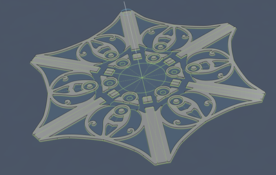

No software should ever crash. Mirroring and patterning large quantities of sketch objects is not recommended and almost always results in bad sketch and overall model performance. That is unlikely to change any time soon.
I am not sure where you find lack of symmetry.
The small section I have extruded is mirror symmetric:
And then rotational symmetry is created with a circular pattern, which coincides with all the sketch elements:
So for this object, the only thing you'd need in the sketch is 1/12th of the sketch objects. That will make a huge performance difference.

Yes, but don't mirror fit point splines.!
@alexander_bastidas_fry wrote:
...(I think that I did, but I referenced a svg)? How did you know they are imported?
There are many end-connected curves that don't have any tangency constraints applied. That often results in near-tangency problems when 3D modeling. This is a very common occurrence with imported svg files, because the originating software doesn't need the precision required by Fusion.
Again, don't mirror fit point splines. If you edit a mirrored fit point spline it will lose it's symmetry.
If you must mirror a fit point spline, then do that after completing all edits on that spline.
If you can record such a crashing incident (I use OBS Studio) and provide the crash report number and the Fusion file, I'll tag an AD employee to record the issue so we can get that fixed.
