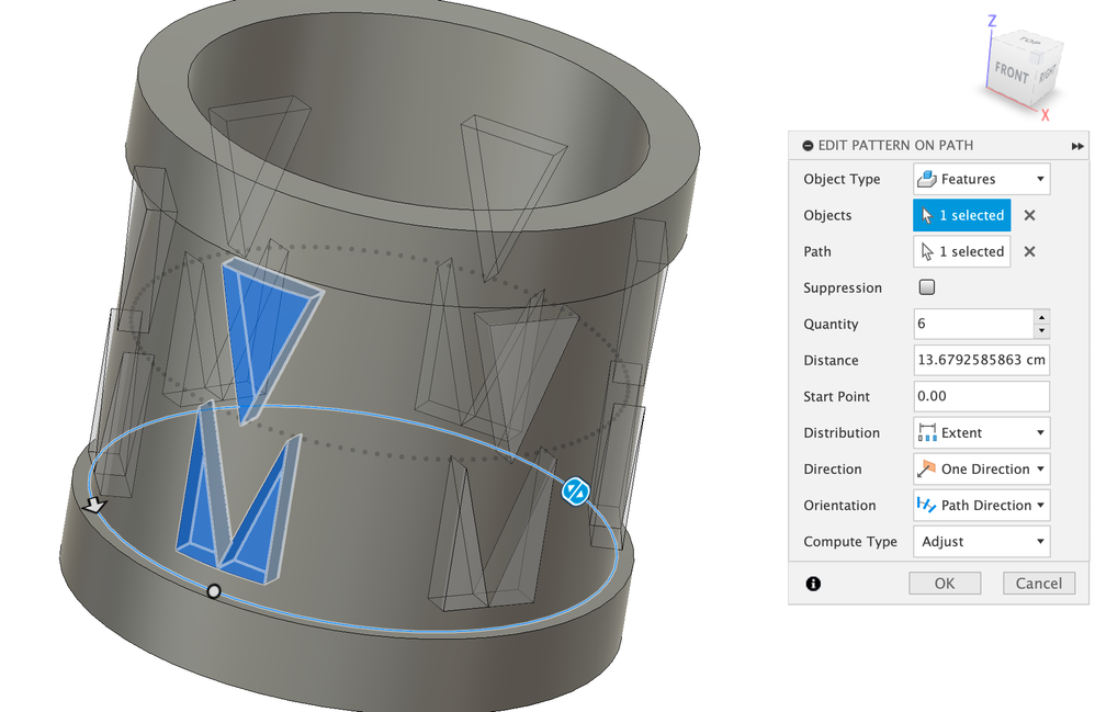

It works as a feature pattern, with the compute type set to "Adjust"

With pattern of any kind, the rule is:  try all the different types.  One of them will probably work.
If I were to speculate, the "too complex" error is because of this non-manifold edge:
That can't be manufactured.  But, that is just a guess....
edited model attached.

and yes, @jhackney1972 is right - circular pattern is better than pattern on path in this case.  However, it has the same problem.  Circular, also, does work for Feature/Adjust..

Thanks, this fixed it. Idk if that point will work with my 3D printer or not, but the point is to find out
