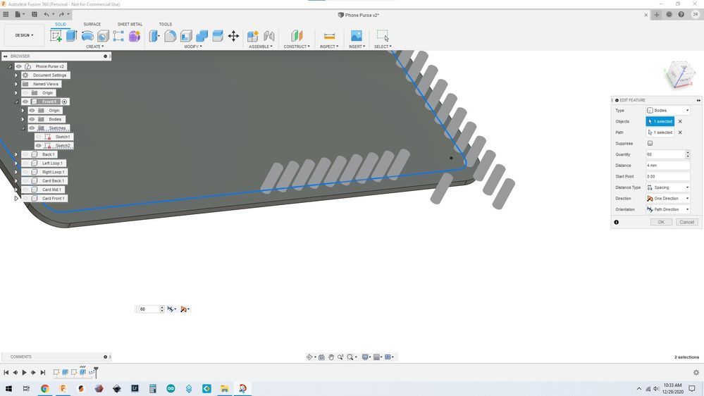

The pattern does not follow the path, the path was created by offset then I tried with just straight lines and 2 point arc, same result.
I've tried this with features (opt/id/adj) and bodies and I get the same result, looking for suggestions, thanks
5,057 Views
22 Replies
Replies (22)
Message 2 of 23
g-andresen
From your screenshot on the right, I suspect that the position of the first instance is not identical to the starting point of the path.
This leads to such results.
Simply change the starting point or place the beginning of the path on the first instance.
günther
Message 3 of 23
TheCADWhisperer
Message 4 of 23
ruebarb.jason
Thank you very much, that fixed it, I didn't realize the pattern and the path needed the same starting point.

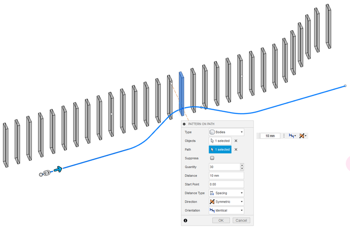

Hi Guenther,
I seem to have a similar issue, however, with me, the objects to copy along the path are placed at the center of the path and ON the path. I would like to create a symmetrical pattern, but this fails. The following I notice:
  1. Fusion seems to calculate the path from the left instead of starting in the middle and going symmetrical.
  2. The "Starting Point" field behaves strangely:
    1. Any value except for "0" and "1" makes everything disappear.
    2. Each time your switch between 0 and 1 the orientation of the pattern switches.
It seems, the Starting Point field behaves more like the "Flip" checkbox known from other commands.
Comment from my side: Other commands use the term "Offset" to shift things left/right. Unfortunately, in Fusion 360, the creativity regarding terms and, sometimes, design of dialogues seems to be very large. - I urge you to have a UI designer look over things and unify them.
Back to the topic: How do I make the pattern follow the path?
If you got the time, could you please explain the background to what is important with patterns on path. I watched your other screencast but without any explanations this is simply useless if you try to understand the workings behind things.
Thanks so much!
Thilo

Mark: The Start Point field turns red with any value apart from "0" or "1". You can toggle back and forth between these two. Every time you switch to "1" the orientation changes.
Would be great if you found a solution. Pattern on path is kinda a must-have...

See Attached file...
0 is beginning of path, 1 is end of path.  0.5 is midpoint of path.
Message 14 of 23
Thank you @TheCADWhisperer ,
That is quite a revelation! So "0.5" works, too, for the Start Point.
(Why don't they provide a dropdown here like for the other settings? I wouldn't consider 0.5 to be intuitive...)
Anyway, I can reproduce what you came up with. However, in my example it only works if you select "Extent". Once you switch to "Spacing" all patterned copies disappear.
Strangely, if you use that slider within the sketch instead of entering values into the dialogue, then you see something again. Just nothing really helpful.
Do you have any idea on this?  (File attached)
Thanks again.
Thilo

Dear @g-andresen ,
Thanks for jumping in here! The objective is actually to use the "Symmetric" setting under "Direction" since I have an element that should be exactly centered.
However, I can switch to "One Direction".    (Still working wih my last sample file I uploaded above.)
Starting with the element in the middle I get the following result:
I may not set a negative Distance then to go in the other direction. The field turns red then.
But now things are getting funny... I am tweaking the "Starting Point" field ...
  1. All values between 0 and 1 seem to be allowed. They stay black.
    (Again, I would rename that field and maybe use a percentage. Although an offset distance would definitely be more suitable.)
  2. Values outside of that range turn red.
    But...
  3. ONLY the exact values of 0 and 1 deliver results.
    Event with 0.5 all elements of the pattern disappear.
  4. This time, 0 and 1 flip the direction of the pattern.
Right now I am utterly confused about how these settings work together. I have the feeling that the usability of this dialogue is far from intuitive.
For now, I have helped myself with the "standard" approach of starting at one side of the path with a fixed setting. However, I will need to be able to tune the spacing and number of elements later, preferably with the customer present. - So I'd be pretty happy if "Symmetric" in combination with "Spacing" and a centered source body would work.
Thanks to y'all again!
Thilo

With the option to create an arrangement symmetrically on the path (starting point 0.5), there is currently no way to align features on the path direction.
If you want to have an instance in the middle, you can also achieve this by creating the pattern in one direction from start point 0, positioning the first instance there, and making the number of instances odd.
