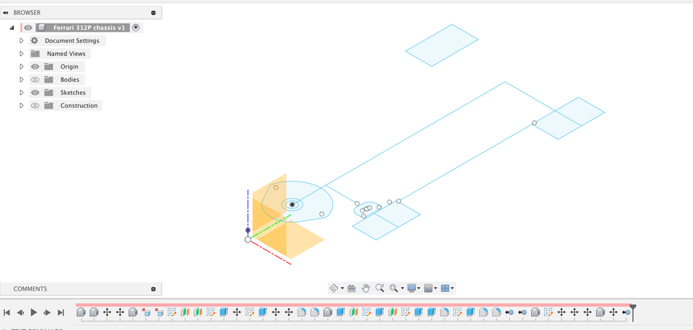

The engineering team is still investigating the "612P+ff-050+pod.f3d" file.  But, they tested (and I also verified) that the large file (Ferrari+312P+chassis.f3z) does open correctly:
Can you try again to see whether you can open this, and if the result looks like what is shown above?  Thanks.

I tried to open the Ferrari+312P+chassis file.
After 7 minutes of the spinning blue wheel, I got this message
"Corrupt File
The file you are trying to open or operate is corrupt! the current operation will be aborted. File name: Ferrari chassis v19"
Weird that it opened for you.
Cheers, Peter
