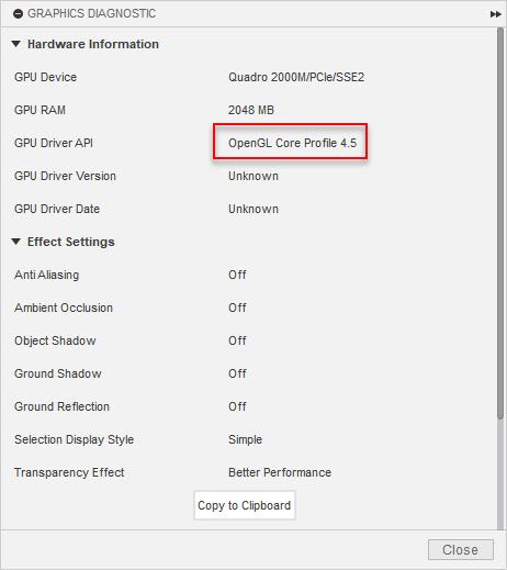

I run a Nvidia graphics card and the driver is uses is an OpenGL Core Profile so I use OpenGL as my graphics driver in Fusion.  I would run the Graphic Diagnostic, under the "?" mark, Support and Diagnostics and see the information present and then react to it.

Following up on this- hopefully this helps others.  I never did get this to work, so for the past few weeks I have been running F360 on a different machine.  Then, after the new version dropped on the 11th, I figured I would try again on the Inspiron.  I uninstalled everything, installed the new version, and it would startup on the first attempt after the fresh install, but shutting down and restarting the program was a crap shoot.  I have since changed the "Graphics Driver" setting to "OpenGL Core Profile", and of course there have been a couple of new software patches since the release on the 11th.  Either way, I haven't had a problem running F360 on the Inspiron for the last week or so.  I don't know if it was the new software patches or changing the OpenGL setting, or maybe both, but it works for me now.
