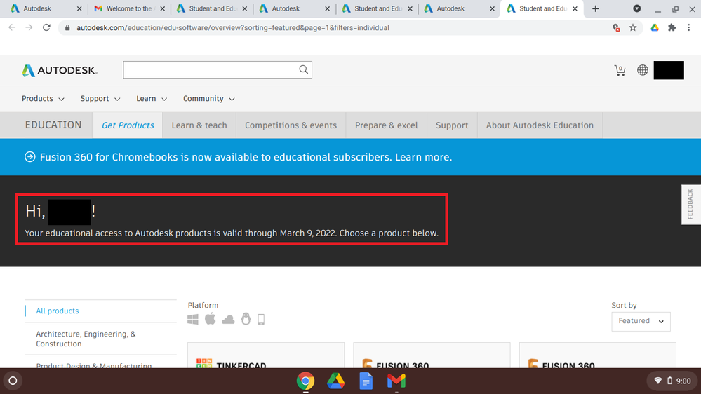

I am an IT professional for a private high school. I have a class full of students who are unable to access Fusion 360 on their Chromebooks EVEN THOUGH THEY HAVE VERIFIED THEIR ELIGIBILITY FOR ONE-YEAR OF EDUCATIONAL ACCESS.

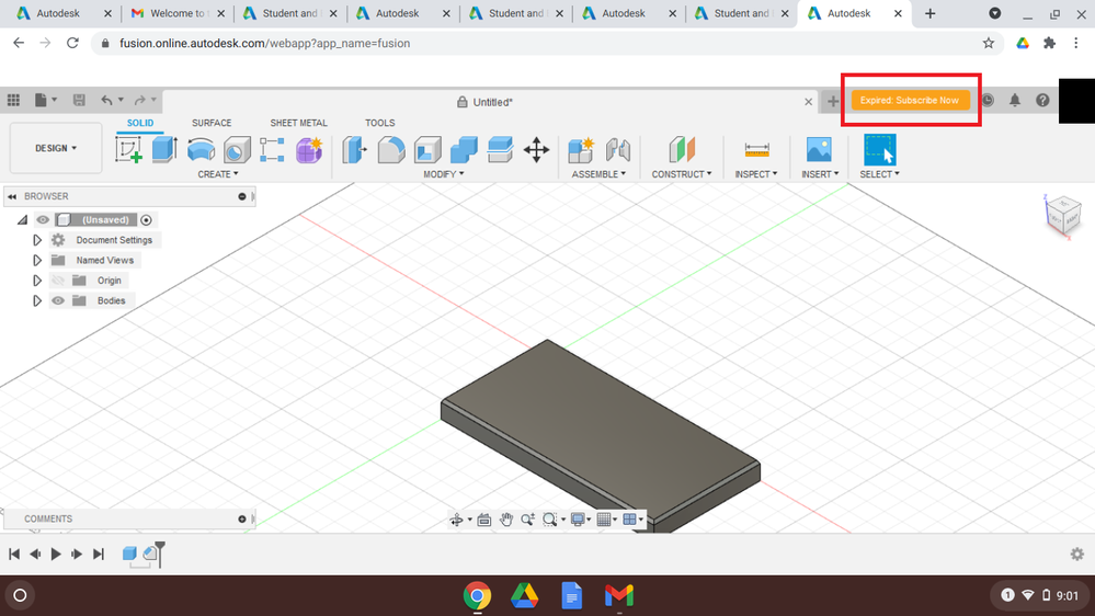

When they actually launch Fusion 360 on their Chromebooks, the students are unable to save their work, and see a message that their subscription has expired:

Having the same issue here. But on youre first image what does it say below the fusion 360 button. Does it still say get access?
Message 3 of 19
I does not. Instead, it says "Get product" - see below:

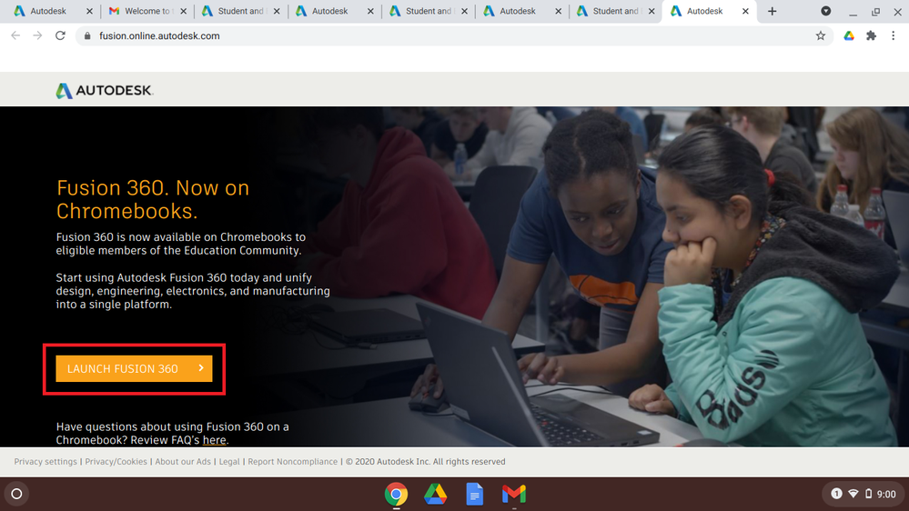

When the students originally clicked "Get product" for Chromebook as shown in my screenshot, I don't recall seeing an "ACCESS" button at all! Rather, clicking "Get product" on the Chromebook option would simply bring you to a launch page that looks like this:
After clicking "Launch 360," Fusion Online would begin to load. Once loaded, the Expired Subscription message would be shown in an orange box in the upper-right corner, indicating that the education license did not activate properly.
