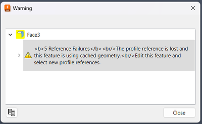

I did take a look at the model, it does however seem that there is a problem when editing the model,(see attached) which is what we do on a regular basis, as clients needs "shift". The reason for our "bad" drawing practice is implemented in our office as standard drawing practice for the past 18 years. The reason for the drawing practice we use is to simplify working in various formats E.G we work on AutoCad 2024, Inventor, Revit as well as Fusion.If you have access to the software design team please mention that all evidence on the non responsiveness and spinning wheel point to a thread waiting for an integrity check or a long running uninterruptible computation. Always better to fix a problem than to have a workaround.

Yep. When you put all that geometry into one sketch, you have no other choice but to select all of it to create the flange feature in the timeline. When I edited the sketch and deleted all the unneeded sketch geometry, the Flange tool now lacks most of the previously detected sketch profiles and works with cached geometry.
This is another reason why it is not recommended practice (in any modern parametric CAD software, including Inventor, SolidWorks, etc.,  to put all that stuff into one sketch and work with modeling features instead. I should have edited the flange feature to delete the previous profile selection and re-select it.
You engaged in another bad sketching (not drawing!) practice by working with a single sketch instead of breaking it into one sketch for the flange and one or more for all the features you want to add.
My model is not a workaround; it demonstrates recommended best practices for working with parametric, history, and feature-based CAD software.
My recommendation would be to overhaul your company guidelines and bring them in line with modern tools!
