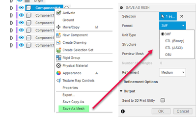

I am trying to save two components as a mesh so I can export it as a stl file, but I have no option to save as mesh when I go to the project browser and select the component. Does anyone have a fix for this? Thank you

should work this way

I have this same issue - there is no "Save as Mesh" option in the right-click drop down for the component.
The body is there in the component.
I had a student re-create his design in the app (not online) and it works, but for the online version, there is no "save as Mesh" option??

With the browser version you can't have any of the local save options because you're running on a remote desktop. Only workaround I can think of is use Derive to save the component out to your hub then download as an STL from your hub.
