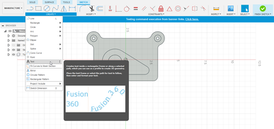

Edit a defined manufacturing model and start searching for "Text". No usable option is available.
I suspect this has to do with me having the "Text" pinned as a shortcut in the "Design" environment. I notice that there too once pinned the Text toolpath is no longer listed in the shortcut dropdown list.
But in this environment nothing is pinned so Text should be in the available list.

@g-andresen We now have a quasi-modeling workspace in the Manufacture environment called "Manufacturing Models". It does give us a limited segment of modeling tools:
And no, text isn't on the list, but it does seem to me that is an oversight. I'll ask the MFG models team if this is intended

Please note that adding text does work in manufacturing model already. Add
a sketch and in it, add text.
The scenario discussed here is about accessing Text directly after entering
model's edit mode, without creating a sketch for it first.
