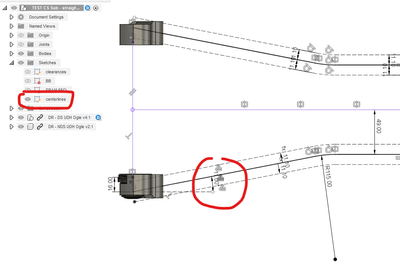

I have thousands of hours designing 3D and 2D drawings for bike frames. I developed a very robust workflow that allows me to change the 3D design and automatically update the 2D construction drawings.
This month I have noticed that 2D drawings break EXTREMELY easily. One minor change to a 3D part sketch breaks several pages of 2D drawings (most are not even related to the component that changed)
In addition, anything that "shifts" the component on the 2D drawing breaks the links:
I am very confident the drawings breaking is a new bug. I had spent many hours developing my workflow to keep the drawings linked, now change breaks them all!
Is anyone else experiencing this? Can Fusion360 tech support help out?
EDIT:
I created a test file to show the bug:
https://a360.co/3EJSS4t
A minor change to the angle of the tubes:
Breaks any dimension that referenced the tube:
It is almost as if Fusion is re-generating completely new bodies every time, and the link to the 2D sketch is no longer maintained. A month ago this was never an issue.

I downloaded your drawing and model which you say shows a problem with disassociation of dimensions in the drawing after an angle change in the model.  I do not see any issues or problems in the update.  I did it twice to be sure.  It is possible that you need to Repair your Fusion 360 installation using the Fusion 360 Service Utility.

I normally run Fusion 360 on a Windows 10 computer but since you are having trouble on a Windows 11 computer, I switched to see if I had the same issue.  I did and I get the failure! So this is a Windows 11 issue it would seem as it works OK on Windows 10.

It feels like something deep in the back end broke how drawing dimensions are linked to the part. Before, you could hide and unhide a body in a sketch without breaking the dimensions. Now anything that causes the drawing to re-generate breaks the dimensions.

The team is aware of an issue affecting Windows 11 and dimension dis-association, they are actively working on a fix, I'm sure it will be available in an upcoming release.

I believe that the update we shipped today included a fix for this disassociation issue. Hopefully you are back up and running.

@ClintBrown3D @Pramod.kadam Thanks, the update did the trick. I appreciate the quick turnaround. I hope this can be a case for better testing before pushing new releases or the option to revert to a previous version. I lost almost three weeks of work struggling through the dissociation bug. If I were a serious engineering company, it would have been devastating. Luckily I just design bikes 😂
