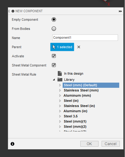

The first feature needs to be a flange not an extrusion. Just because you're in the sheet metal tab it doesn't make the part a sheet metal part, the extrude feature is the same as in the model workspace.
Try just drawing a single line then select the flange tool and extrude. Best practice would be to switch to the sheet metal tab, create a sheet metal component and select the material
then create your first sketch and create the first flange.
