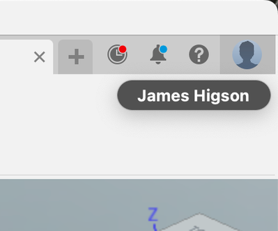

On hovering over the person icon in the top-right I get my name:

Message 13 of 16

Message 14 of 16

I now have access to fusion360 working. This comes down to a small but significant bug in the software that I had to override:
  • If the user has changed their email, F360 can get into a confused state where the user is half logged in, but changed their email since logging in. In the case the user shows as logged in but cannot log out via the GUI. The fix in this case was to delete LoginState.xml, but it would be good if the software automatically sent the user to the auth in this case.
