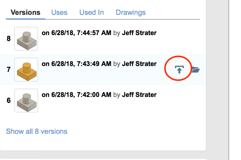

jeff_strater
Hi @Bernd_CAD, I think you should be able to just open the current version of the design and use Modify -> Compute All, and the mirrored component should compute correctly.  If that is not working, you might try editing the Mirror feature, and just hit OK.
If you are OK using the older version of your design, you can use the "promote" command in the data panel to move that older version to become the latest version.

Message 13 of 13
Bernd_CAD
Hello Jeff,
Thank you for your time you spent on the problem.
Now I used the 'promote' command and moved an older version to the top.
No problems any more.
Thanks again and best regards,
