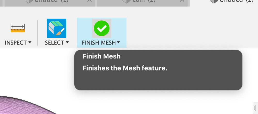

Message 8 of 10
jeff_strater
well, not really.  You can create a new empty mesh using the Create Mesh command:
Or, by importing a mesh file:
then, edit the Mesh feature in the timeline:
this takes you into mesh edit mode.  To return to normal Design mode, use the Finish Mesh command:
