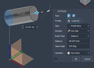

Create a random cylinder with a 3D sketch:
Construct a tangent plane on the cylinder surface
Start a sketch on the new plane and use project/include > intersect on the cylinder
Use edit feature to adjust the angle
