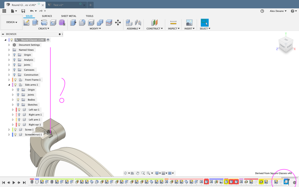

Unfortunately this hasn't worked. I've derived the part into the new file but it's not showing up there.Screenshot 2019-03-05 at 00.31.27.png

@Anonymous - can you provide a bit more info to help us understand what didn't work?  It looks like you have a Derive feature in your model.  If you use the Derive workflow that I showed, and select "new design", it should produce an entirely new design with only that Derive feature in it.  It looks like you may have followed a slightly different workflow than I did.  Ideally, if you can provide a screencast of what you did, and the design that you want to use, it will be easier to help you.  Thanks!
