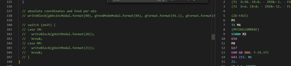

i found where is the problem if i delete the first part and the last part the code is good but now i neet to know how to change in my post processor to don't generate the first part and last part

HI @andrei2306KSQQ6
Thanks for raising your concern via Forum.
You can remove the NC codes ( not required ) by simply commenting the respective code snippets from post.
To edit the post you can use the Visual Studio code.
For detail info about the post editing please refer the  FAQ link
1. To omit the codes from header
   a. Go to line number 338
   b. Put'//' in front of below codes.
 writeBlock(gAbsIncModal.format(90), gFeedModeModal.format(94), gFormat.format(91.1), gFormat.format(40), gFormat.format(49), gPlaneModal.format(17));
 switch (unit) {
  case IN:
    writeBlock(gUnitModal.format(20));
    break;
  case MM:
    writeBlock(gUnitModal.format(21));
    break;
 c. Go to line number 774. Give condition in 'writeRetract(Z);' to omit the homing codes from header but it will appear after tool change.
// retract to safe plane
    if (!isFirstSection()) {
      writeRetract(Z);
2. To omit codes for program end
    a. Searh 'function onClose() '
//setCoolant(COOLANT_OFF);
//writeRetract(Z);
// writeRetract(X, Y);
Regards
