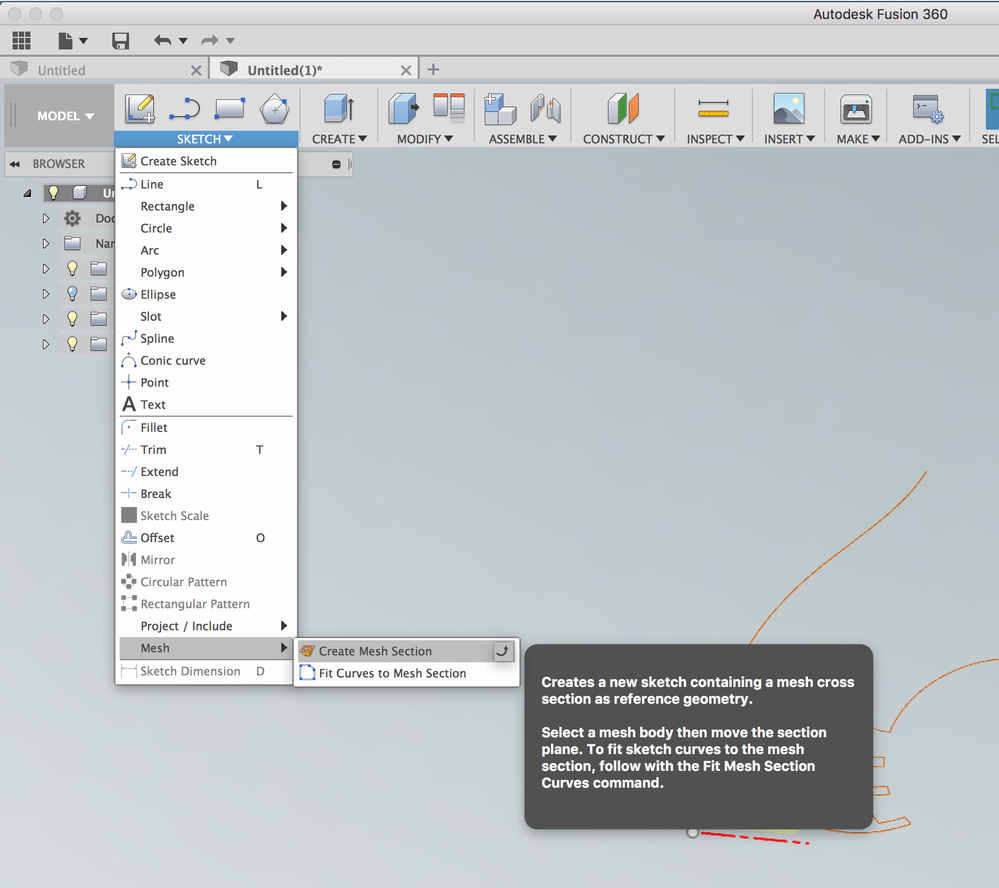

yes, your mesh has way too many facets.  I think the limit is 20,000 for this conversion.  What are you looking to do with this mesh?  You mention projecting it to a sketch.  Have you tried out the Mesh Section tool?  This is not a project, but is a cross-section through your mesh - it's good for doing reverse engineering to re-create a BRep from mesh data.  I'll post a video shortly.

After importing the mesh you need to change into the Model workspace and create a mesh section. I am wondering what you want to achieve with this though.

The screencast below is just a sample of the workflow.  It's not clear exactly what you want to do with this mesh, but this will give a flavor of how you can use these commands to create sketches, which can then be used features such as Extrude, Revolve, Loft, etc to rebuild your model.
