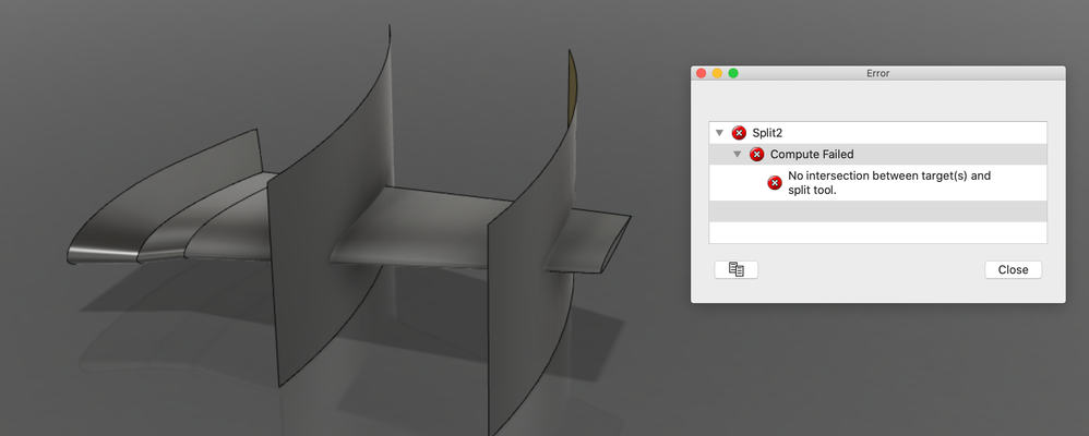

I have looked at the model and don't see good reasons this should not work.
The wing profiles are created from straight lofts between closed fit-point splines with 6 control points.
The Cutting profiles are arcs.
Extruding one of them and trying a splint body operation also returns an error Clearly there IS and intersection.
Edit, some more experimentation indicates that the trailing edge is the problem.
