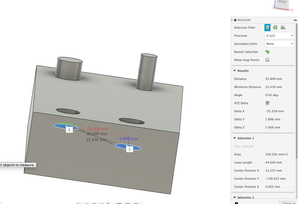

@HughesTooling - I do get the delta XYZ for the bottom of the hole as well as the top of the boss:
I would have been very surprised to see that they were different - that would have implied some pretty advanced topology analysis to treat them differently.
However, your points about if the body is rotated are certainly accurate, and a problem.
And yes, there are lots of inconsistencies and bad workflows in Measure.  I certainly hope to address them one day.  No promises when, however...
You're right, I didn't notice one of the holes had a drill point not a flat bottom. I think the last update might have improved thing as well, I tried to measure between the top of 2 bosses a few weeks ago and only got a minimum distance but when I tried the same design now I get the XYZ delta option.
In another CAD system I've used you had the option to project the XYZ deltas to a plane giving just an XY dimension, this was useful for rotated parts.
