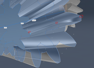

I was trying to design this object gear (Fig. 1) that I have already designed in Solid Edge, with Fusion 360 Personal Edition.
beside some small orientation error, I achieved this in Fig.2, but as yo ucan see the conical gear has 2 main issues:
1. some incorrect profile ONLY on one "tooth"
2. the conical shape is slightly turning (not able to turning more) and it's NOT helicoidal, as it should be from Fig.1
For the point 1 I think it's an old issue of Fusion (please confirm or correct me)
For the point 2.
I tried with "lofts" but they can't be twisted.
I tried with "sweeps" because they can be twisted, but they can't be lofted (I mean to terminate on different size shape than the original). "Tapered" doesn't do the job.
After several trials I just gave up and decided to ask to you suggestions.

TrippyLighting
The loft fails because Fusion 360 gets confused in adding edges. This is a bug @Phil.E
You should be able to work around this and create a computationally faster model by lofting a single tooth and circular patterning the loft feature in the timeline.

I've made a circular pattern of the created body (the whole one, because to select the single tooth it was not possible, so I selected the whole body and patterned 12 times)
Yes I smashed my face against the bug od Fusion as wel, I corrected it by manually moving the points. I hope this bug will be solved soon. Meanwhile here below what I did. Thank you to both of you.

tormy.vancool
Thank you really so much.
Message 19 of 21
jeff_strater
This is a "loft default point mapping" issue.  Basically:  Loft has to try to map between points on each profile.  It is harder than it looks - there are a lot of points here, and the helical nature of this loft probably confuses the algorithm a bit.   You can fix it a number of ways.  You can drag the white dots in the preview to try to "untangle" the twisted edges, which is possible, but can be tricky.  Or, you can add rail curves.  Usually just a single rail curve is enough to avoid the confusion.  However, in this case, just lofting the other way seems to avoid the problem.  Not sure why, but it gets around the issue...
