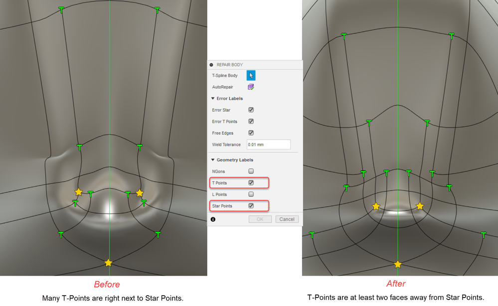

Attached is the model that I manually repaired. Your original model had the following problems:
1. Some faces intersect other faces.
Recommendation: Use Edit Form in Box Display mode to move faces, edges, or vertices to avoid self-intersections.
2. Lack of topology flows.
Recommendation: Watch Topology With T-Splines In Fusion 360.
3. T-Points are right next to Star Points, causing bad surface quality.
Recommendation: Use Insert Edge or Insert Point command to position T-Points at least two faces away from a Star Point.
4. L-Points exist, causing bad surface quality.
Recommendation: Make quads (four-sided faces) to remove L-Points.
