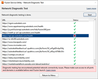

Good afternoon. I updated fusion as standard and after that it won't let me into online mode, the diagnostic tools say that there is no response from one of the addresses. https://api.aps.autodesk.com/health
During manual verification on my part, there is a connection to the server, DNS and TCP/443 are working, but endpoint returns 403 Forbidden:
curl.exe -I -L --connect-timeout 10 --max-time 20 https://api.aps.autodesk.com/health
Result:
HTTP/1.1 403 Forbidden
content-type: text/html; charset=UTF-8
via: 1.1 google
Also:
Test-NetConnection api.aps.autodesk.com -Port 443
Result:
RemoteAddress : 34.149.246.28
RemotePort : 443
TcpTestSucceeded : True
However, before the update, network diagnostics had access to all addresses.
I tried repair fusion but it didn't help.

There is something funky going on with this.  I resolved this by pointing my DNS servers manually to 1.1.1.1 (Cloudflare primary) and 8.8.8.8 (Google Primary). And what do you know? It worked as it did before the update.  However, I do not want to leave it here.  But it did get me up and running.

Manually setting DNS worked for me too.
Assuming you're on Windows:
1. Open your Network & Internet Settings
2. Click on "Properties" at the top
3. Click "Edit" on DNS server assignment
4. Change the drop down to manual
5. Turn on IPv4 and enter the following:
  • Preferred DNS: 1.1.1.1
  • DNS over HTTPS: On (automatic template)
6. For alternate DNS:
  • Alternate DNS: 8.8.8.8
7. Restart Fusion and (optionally) run a network diagnostic test from the fusion service utility.
Message 17 of 17
ytka1488
I did it all. But it didn't work. Still an error in https://api.aps.autodesk.com/health
But the cloudflare program from the website has helped me so far. https://one.one.one.one/
in traffic and dns(udp) mode
you just need to turn off all vpn and other settings, if you have
