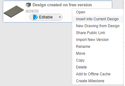

Can it be that they are "auto deleted"???
Answer: That is impossible. The Delete command is distinct from other commands and cannot run unless you select something, right click, and pick Delete from the menu as you see in the image below.
