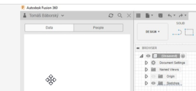

I will add more info:

HughesTooling
Your data panel looks odd, it doesn't look like you have any projects. There was a problem reported where Fusion ran badly if you delete all projects and designs. Have you saved any projects and designs to the hub you're using in the image below? PS please don't attach pictures, either paste into message or use the insert photo option.

tomas.baborsky
No no, I deleted it in painting :-))
I have there some private projects and names of my costumers...
