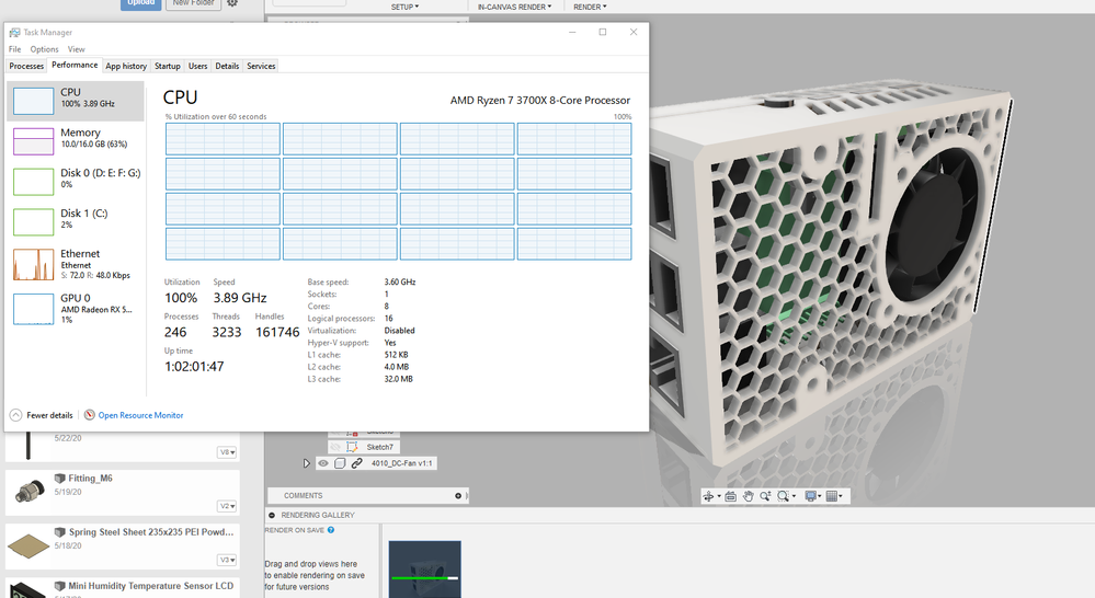

Maximum Quality Render:
5700XT GPU 0-1% use. How can I use my GPU to get renders or work done quicker?

Hi @Bajicoy,
Down at an architectural (code) level Fusion isn't GPU Accelerated so there's nothing you can do to make it faster, CPU is the main factor and you've got one that is excellent for Fusion.

Bajicoy
Okay, thanks, I'll check back in another half a year and see if anything changes. Thanks for the quick reply 🙂

我的也是一样,CPU占用100%,GPU却在打酱油,4090好浪费~

好吧,我3090,也是几乎没动,cpu跑满了
