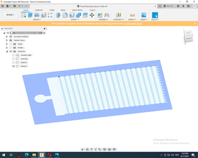

Good day, everyone.
Here you see I have 4 sketches and only one of them is visible. I'm trying to select all the slots on this sketch and only push-pull them. But it keeps selecting other stuff that is  very clearly disabled and it is driving me up the wall. How can I fully disable that feature and only be able to select what's on the sketch I'm editing?

Auto Project in preferences, will give profiles not required, and
your slots, may not be fully contained profiles if the end points are open.
