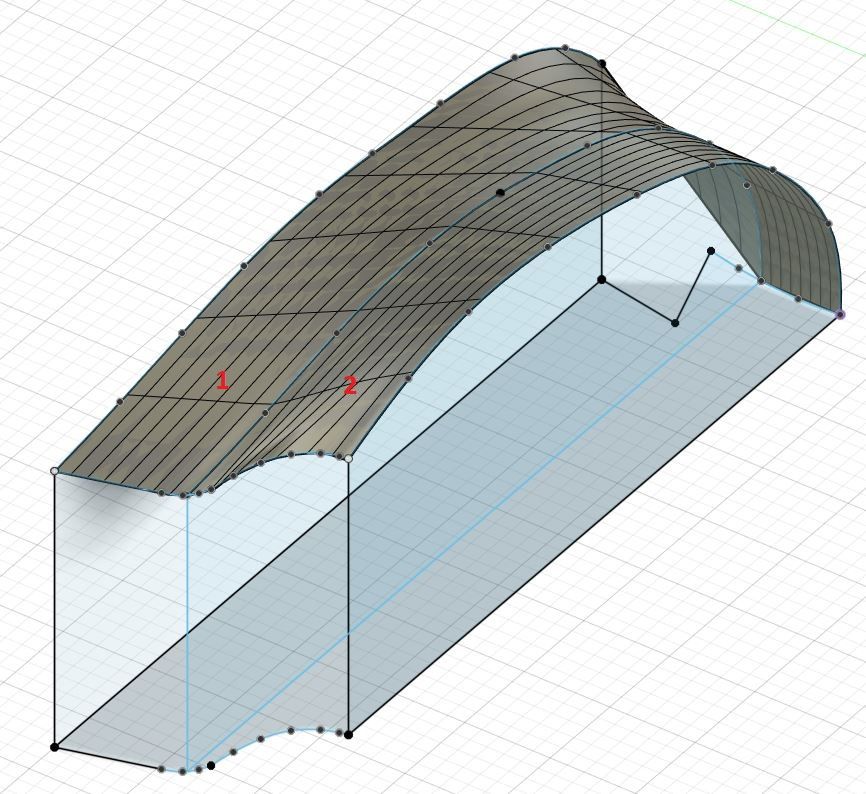

In Fusion 360 I try to merge 3 surfaces in one without distortion (see capture).
Is there a way to do that ?
I didn't find a solution after many tests...

Message 4 of 23
jeff_strater
an important point here is:  This design is already one body:
If you don't want to see the lines between faces, just choose "shaded" as the viewing style:
which will show the model without edges:
Your model does not have history turned, so we cannot comment on how the tangent discontinuities were created, but if this model was created with Loft, there are ways that you can prevent these

davebYYPCU
Too many spline points, too many loft profiles, will do that distortion to you.
If you used more than one loft, yes you get distortion.
This does not need Sculpting, just top and bottom rails, with 3 point spline, but your basic shape does not flow smooth, as my curve combs show.
Might help.....

davebYYPCU
Not checked the file yet.  There is no “quick” in Fusion, good preparation works well.
No trick, less is better, but you will have to replace splines with that many spline points, or
you waste your time.  Mine is 2 and 3 point spline.
just do one surface loft, not sculpt, eliminate centre geometry,
top to bottom, (3 point spline) and front to back ( 2 point spline (and tangent line for back.))
Middle one is causing bumps and groove.
Might help....

I generally agree with @davebYYPCU observations.
However, I actually looked at the file and what I see confirms what I already suspected. You don't have enough of experience in CAD and in particular surfacing and T-Splines to assess Futons 360's abilities. Most Fusion 360 users don't have enough experience to assess Fusion 360's abilities in the area of surfacing or T-Splines.
This is a surfacing project all day long and should NOT be done with T-Splines.
Here is what I would recommend. Pick a concrete project of medium complexity and try to do it with Fusion 360.
Start a new thread and share the model early on, perhaps after the first sketches. Then we can guide you much better and you'll avoid the mistakes in the model you have shared. These aren't only mistakes in terms of the techniques and tools used, button a deeper level they indicate a misunderstanding of concepts.
I'll create a little screencast later how I would create such an object.
