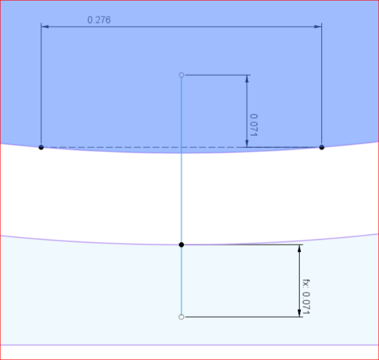

I've been searching but haven't found anything like this.
I have a solid body, that I have cut with a cylinder (glass, which is 2.45mm thick) into two bodies - B1 and B2.
I now want to 'cut' a rectangle into the 'inside' face of each body, to accept a super-magnet at matching points, such that the magnet in B1 lines up with the magnet in B2. I want to do this at 4 points along the length of the body.
The 'super' magnets are 6.5x10.6x1.75 mm. So, what I want to do is to 'cut' a 7x11 by 1.75mm deep cut into the two bodies, at the same point (such that they match up on each side of the glass tube).

Cut the notches in both parts at the same time, with a sketch on the splitting face,
Extrude 2 sides 1.75mm deep on both sides, tick both bodies to cut.

davebYYPCU
Slightly different sketch, but same detail.
My construction plane is set at pattern spacing, 1.6 in
Project > Intersect the bodies, and draw a vertical centre line, set depth of cut from each body (1.8mm),
and used symmetric thin extrude to cut both bodies, (fillet corner edges if required before the pattern)
set spacing to 1.6mm and pattern (feature/s) the other 4 magnet sockets.
Might help....

davebYYPCU
Edit sketch, remove the perpendicular constraint on the blue line, and make it 15 /105 degrees.
Cut the first pair, then mirror that cut to the other side of centre, (feature)
Edit the pattern and Cntrl Select the Mirror icon into the pattern.
if the starting position is not right edit the distance from the end of the block, with the sketch offset plane distance,
If spacing is not right edit the pattern spacing distance.
