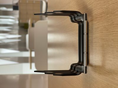

Also, here is an actual image of the physical component that I am trying to model to help you understand the goal!

Rathan that focusing on the component that I provided (and should have deleted first) - do you have advice on how to create a rib on the outside of a bend?
I am effectively trying to design a component for metal die stamping / metal forming. The corners in my model will need to be reinforced.
Sorry for the messy component - I should have deleted that one before attaching it here...
