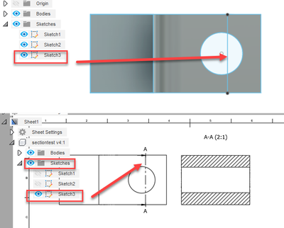

g-andresen
1. You must create sketches for section views in design mode. For this purpose, lines  can be generated at the specific positions.
2. after the design has been saved, the corresponding sketch can be activated in the drawing mode and used to create the section plane.
