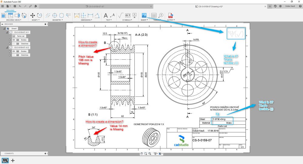

It is a bug? I think the function is missing.
In Inventor I can use: 1.Sketch, 2. Retrieve Model Annotations, 3. Get Model Sketches and maybe other

I would like to offer a workaround solution to your Pitch Line dimension issue.  Fusion 360 has a ways to go with its 2D drawing application so you have to cheat.  Please take a look at my screencast for the process.

@dusan.naus.trz wrote:
... I think the function is missing ...
That functionality is missing in Fusion 360.
Try to dimension a simple hole callout.
That also is missing and so forth!

Thank you. Interesting procedure. Yes, I understand your video. I don't know if it's right, but you've achieved the result.
I'm sending the video step by step.
