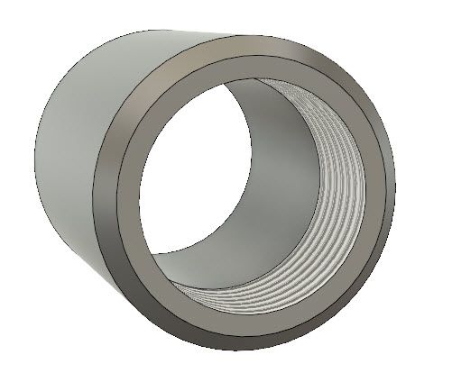

My official first post. I am trying to change the material properties from steel to Plastic ABS. I select "Modify", "Physical Material", "Plastic", and when I mouse over ABS I get a hand and cannot select it. Is there another way to change the Materials Properties? Sorry, I posted to the wrong section.

In order to change the physical material on your part, I believe you have to click and drag the material you want (in this case, ABS) to your part.  Just clicking on the material doesn't do anything.  You can also access the "physical material" dialog by right clicking on the body or component in the tree.

Thank you very much... worked perfectly
