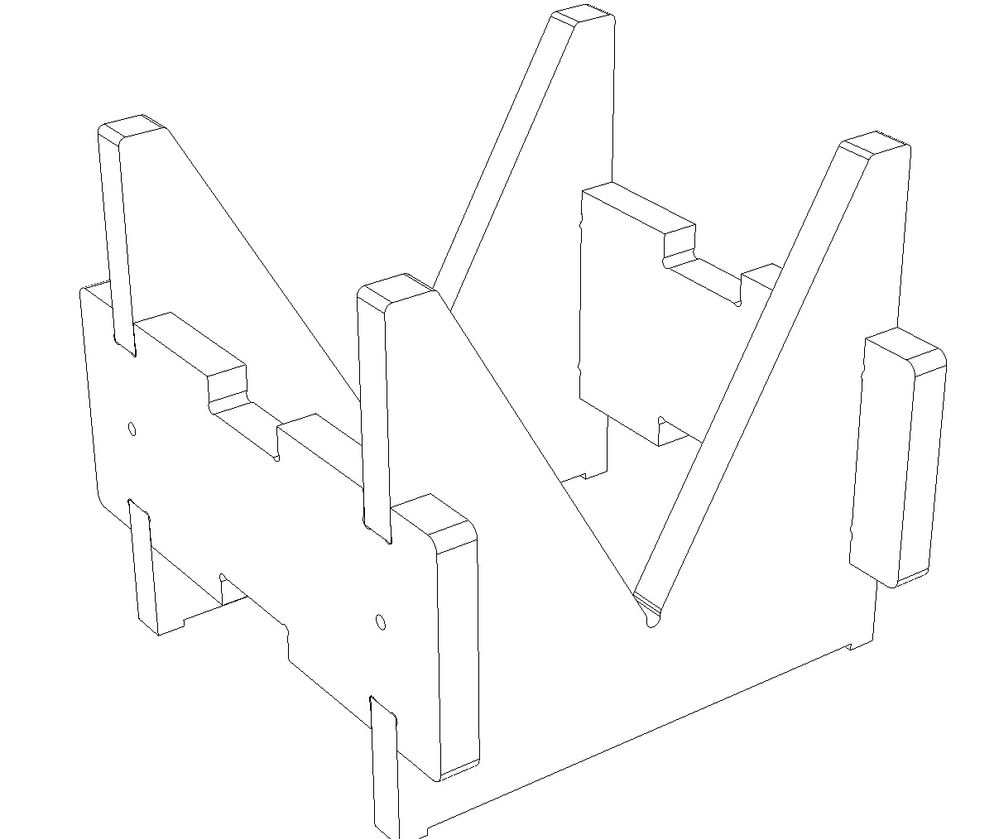

Warmingup1953
Isometric acceptable?
or you can fudge a bit:

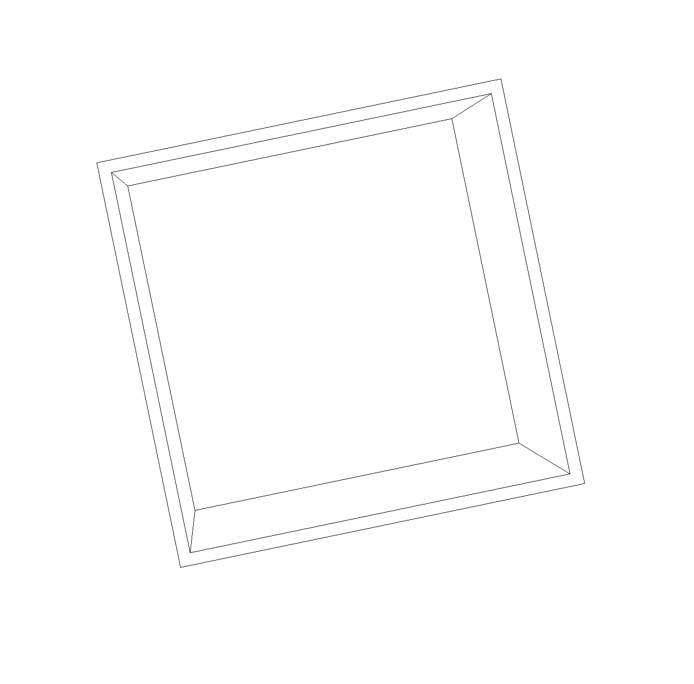

ford33x
Thanks for reply. Perspective allows more features to be seen from a single viewpoint. In attached example, inside walls of box are visible with perspective front view, but not with orthographic.

Warmingup1953
A Named view and then open Drawing Workspace is one way but indeed it's cumbersome and you may not end up with a file format that will work for you. Why not simply screen capture?aa.jpgbb.jpgcc.jpg

ford33x
Thanks for suggestion, but my point was it doesn't work at all, not that it's cumbersome. You can see on the attached image how the named view (captured in 3d perspective) appears after it's imported to 2D drawing. I'm assuming it's just interpolating the perspective view back into an isometric view. It's hard to tell for sure, but your example line drawings also appear to be isometric, not perspective.
Regarding your screen capture suggestion, I would happily capture the perspective image in 3D or use a snipping tool to copy and paste it, if I could eliminate the beige surface appearance that makes it look more like an illustration than a line drawing. But I can't seem to do it. For example, the 3D box image I attached has a WHITE glossy paint surface appearance applied to it, but it still looks beige when saved as an image, which is typically not liked by USPTO for patent drawings. They want line drawings.
