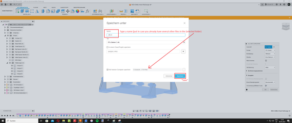

Hi everyone,
I'm about to loose my mind... Since 2 days I'm trying to figure out how to send several bodies to my printing software, but no post, no video, no advice could help.
Previously I would create a folder, drop all necessary bodies in, select the folder, go to 3D-print - Done!
But that unfortunately doesn't work anymore.... I can't understand why and how to procede now...
In the design (see below) I want to send all 4 legs (selected - blue color) as individual bodies to Cura.
I'm able to send them, but ONLY in their current position, so they're treated as one body which does not work for me as I need to individually place them onto the build-plate.
Unfortunately the "Save as STL" option which was recommended in every second post and video I've seen, is not available anymore. Also I can't find the "Send as individual bodies" option, in case that would actually help)
I need to export them all together but have them as individual objects in my printer software.
Pls help!!
With best regards
Nando

The tool you are looking for is named "Save as Mesh".  In the screen capture I have right mouse clicked on the top level assembly and chosen Save as Mesh.  As you can see you can save one file or one file per body in one of three formats.  You can also send the result directly to your 3D Printing software or save the files to disk.

After spending a pretty long time trying to figure out the exact process...
...here a detailed walk-through:
In order to just print the feet:
1. FIRST deselect ALL other (not wanted) parts.
2. Right click on your project - "Save as Mesh" - select "One File Per Body".
( like previously explained by @jhackney1972 )
3. Then select the remaining folder containing the desired parts and click "OK"
4. Now rename (might be important), select a location & "Safe"
5. Open the folder and Drag&Drop the selected files into the Slicer.
@jhackney1972  thx anyways! Your comment finally made me find the way! 🙂
