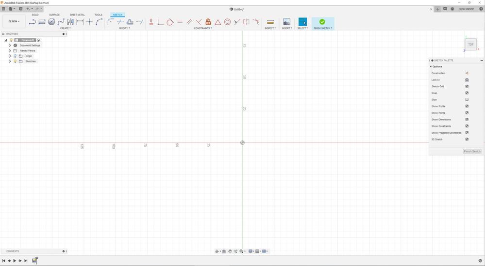

The section of the screen with the names of the open files looks squeezed
- as well as the time-/work-line in the bottom of the screen.

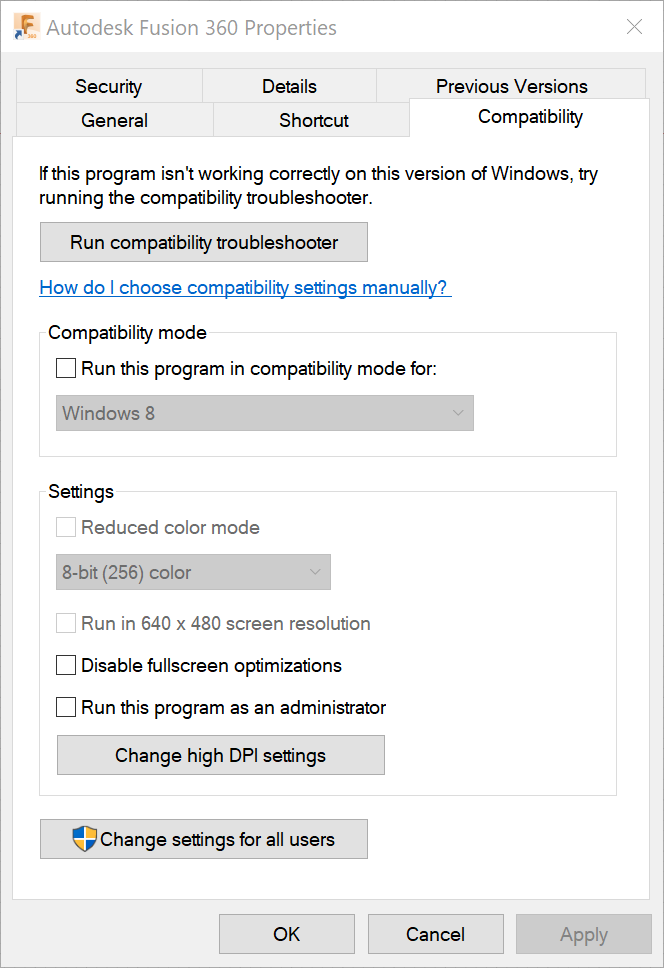

I tried to locate the Fusion360.exe file as well - but the "Disable display scaling" property does not exist in my Windows 10 (or at least, Microsoft decided to call it something else):

Hi @Anonymous,
Yes, have you tried checking that box in your screenshot then restarting Fusion and seeing if that improves it?

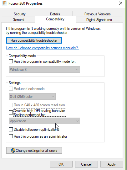

With setting to "Application"
With settings to "System"
With settings to "System (Enhanced)"
In all 3 cases, the title of the current drawing is partially hidden due to font scaling issues.

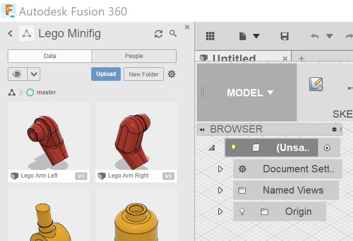

mihai.stanimir
This is how Fusion looks on my 4K display on Windows when overriding High DPI as suggested here https://knowledge.autodesk.com/support/fusion-360/troubleshooting/caas/sfdcarticles/sfdcarticles/Per....
Part of the menu is scaled correctly. In the viewport the numbers/dimensions are tiny and the timeline is very small.
This is how Fusion looks using default Windows scaling. Everything is blurry. My Windows scaling is at 175%.
