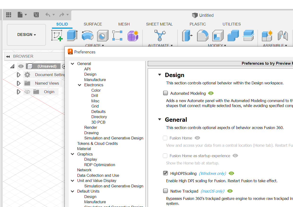

I am encountering the problem where the "HighDPIScaling" setting under Preferences/Preview Features will reset when the program is restarted. The setting will still be selected (as seen in the print screen), but not have any effect.

The work around will only last until restart and then the process has to be repeated. I have tried "Restore Defaults", but that did not fix this behavior. Any ideas?

The "High DPI Scaling" settings seem to persist after multiple restarts.
Fusion 360 after the latest update should be on v2.0.15050. (not 2.0.14793)
If you did not get an update notification, repair Fusion 360 with Fusion 360 Service Utility.

Great, that worked. Thank you
