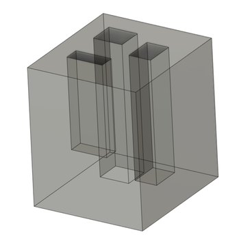

If you change your part to something other than 100% opacity, especially noticable in the 60-90 range, the displayed result looks really weird and even confusing. All of the lines, even if behind some faces, so hidden edges, are displayed like in wireframe mode, independent of how many faces are in front of said line. In the end you have a bunch of faces that are properly dimmed dependent on how many faces are layered in front of them, but you have a mess of lines that don't give any indication of depth because they are all just the same shade of gray.
Here are some visuals to demonstrate what I mean. First is F360, second is FreeCAD. Part is at 80% opacity.
Just ignore the top with the openings and look at the rest. Would you know how the layering of these cutouts is in this case? Mind that this is 80% opacity, so I wouldn't expect to see the lines after the 3rd face at all. I just get a headache when looking at it too long.
This is how I would expect it to be displayed. This way you can see inside and through the part, but the sense of depth is correctly preserved.

I think that most people will agree, the visual styles suck. Unfortunately nothing will be done to improve them or the other years old problems while they concentrate on new gizmos that they can charge extra for to use.
When the opacity is reduced, it shows the hidden lines at full opacity which doesn't make sense.
This is at 80 percent (useless) and then at 100.
