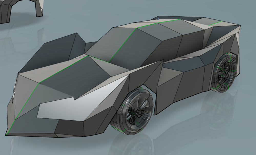

Hello I want to make this form to a body so i can 3d print it. I have tried to use thicken but it doesn't work. Am i forced to remake the body ore can i do something else?

Have you patched the bottom face of the surface body?
Patch and then stitch, should give a fully solid model.
If Thicken doesn’t work then Shell may not work either, and that would come down to Geometry of the body.
Long shot: Print the solid with perimeters only.
Might help.....

If you watch a YouTube video on T-Spline modeling and the author models 90% or more in smooth mode, forget the tutorial. You might notice that Gichi models almost exclusively with quad polygons and almost exclusively in box view mode.
Here is one of your models in Box View mode:
Too many N-gons.
Triangles should NEVER be used in any T-Spline model.
Self intersections.
Etc.
Start from scratch after watching Gichi's vids!
