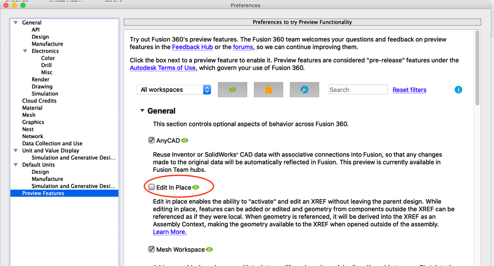

Edit in Place.  OK, saved the best for last.  You know all the problems I described above with dependencies between External Components?  There is a very cool feature just released (described in the what's new?  for March) called Edit in Place.  Here is a forum thread devoted to this: EIP feedback .  Basically, it lets you edit an External Component in the context of a parent design.  You can reference other Components, etc.  The box lid workflow becomes much simpler.  This is still in preview state, and you can turn it on here if you want to experiment:
Hope this has been somewhat helpful to your understanding.  Follow up questions are welcome.  There are lots of details not covered here...
