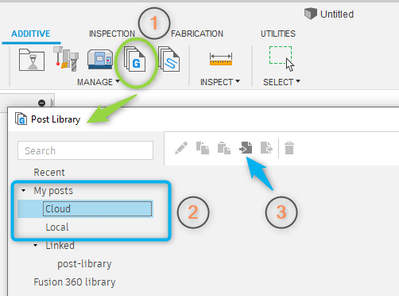

You will need to copy your post in a personnal folder inside the Fusion 360 library for post processor.
1 - Open the post library.
2 - Select a personnal folder, on the cloud, or local to the computer.
3 - Use the import button to move the cps file from your download folder, into Fusion library.
Enjoy our product.
Have a pleasant day.
Regards.
